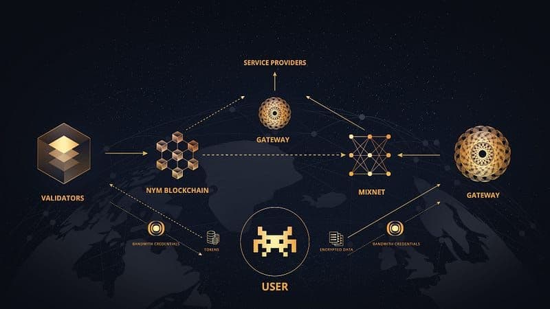

There are four types of nodes that operate the Nym infrastructure: mixnodes, validators, gateways and service providers¹.   Externally…
Externally, the Nym network interfaces with third-party service providers that can offer enhanced privacy to end users by making their services accessible via the Nym network. As a system, Nym is not envisioned to interface overtly with end users. Instead, Nym is a privacy infrastructure that operates at a deeper level of internet traffic. Services providers and applications can extend privacy to their end-users by building and operating via the Mixnet and credentials.

The Nym network is made up of these numerous actors, serving very different functions and operating together in order to make this global decentralised privacy system work. Gateways and Mixnodes make up the entrance to and backbone of the mixnet, Validators act as both its source of truth and for making credentials, and finally Service Providers are the applications (or interfaces to applications) built atop it. Each actor has specific incentives, performs specific functions and has specific powers and responsibilities. We will delve into these in more depth in blog posts to follow. In the mean time, if you want to look into the technical details of setting up any of these nodes, check out our documentation.
