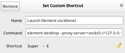

To avoid entering a command every single time, we’ll create a keyboard shortcut using keybinding.
Navigate toKeyboard Shortcuts in your computer settings and choose Set Custom Shortcut. Whatever you enter for the Name and Shortcut fields is up to you, but write the following into the Command line:
element-desktop - proxy-server=socks5://127.0.0.1:1080
Then input your Shortcut, but be sure it isn’t already in use by something else.
See below for an example:
