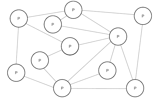

In a nutshell, HOPR is a p2p network where participants are peers that act as both end users and relay nodes that route the data packets of others. New participants join by contacting one or more “bootstrap nodes” that give to new users a list of peers they can connect to to become part of the HOPR network. A gossip protocol is used to discover more of the network: peers share their list of contacts with others to enable them to connect to each other. Knowledge of many other peers and existing connections between them is necessary to send data via HOPR. Peers encapsulate data in Sphinx packets together with per-hop probabilistic payments and route these packets through a few intermediaries to a receiving peer.
Example of a p2p network

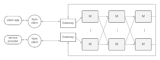

In contrast, the Nym network is a decentralized mixnet that is designed as a client-server architecture. In Nym there is a clear distinction of roles between the end users, who send and receive anonymous data packets, and the relays or mix nodes that provide the service to those users. The expectations from these two classes of participants are significantly different: while the end users may be offline most of the time and have small devices or flaky connections, the mix nodes run on a set of well-maintained decentralized servers that are incentivized to reliably provide high quality of service to thousands of users at any time. In Nym all end users obtain the full list of available mix nodes with their corresponding keys. This list is published at regular intervals in the Nym blockchain, ensuring that all participants have a verifiable, global, up-to-date and consistent view on the mix nodes forming the network. Instead of establishing ad hoc connections to a set of arbitrary peers (as in HOPR), in Nym the mixnodes are structured in a layered topology — which is known to be the optimal mixnet topology in terms of both privacy and scalability. All users choose routes through the mixnet layers following the same probabilistic algorithm, a feature that maximizes privacy by not making users stand out based on their routing choices.
Nym client-server mixnet architecture
