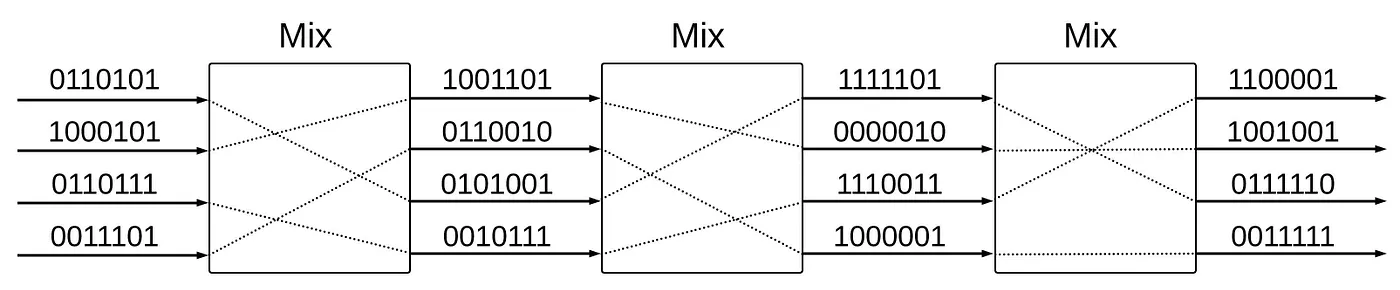

In the traditional mix network, the nodes are ordered in a fixed cascade, and each packet is routed via each node from the first to the last one. By using multiple mixes we distribute the trust among them, hence as long as a single mix in the cascade is honest the anonymity is preserved.
Each packet relayed via a mix network is layer-encrypted (or in other words onion-encrypted) using public-key cryptography. Upon receiving each packet, a mix strips a single layer of encryption. This ensures that whoever is observing the network cannot trace packets by looking at their binary representation.
Despite changing the binary patterns, the eavesdropper could still correlate the timing of the encrypted packets on different links if the mix forwards them following the first-in, first-out order. In fact, this is the exact kind of attack that Tor is vulnerable to. Therefore, in order to prevent that, each mix collects a certain number of packets, decrypts and simultaneously reorders (mixes!) the packets following a secret permutation. It’s a bit like shuffling a deck of cards, so the term “shuffling” is sometimes used instead of “mixing.”
Once the packets are shuffled, the mix sends them to the next node in the cascade. The other packets which were not accepted in a batch, are sent in subsequent rounds. This is a so-called batch-and-reorder mixing technique.

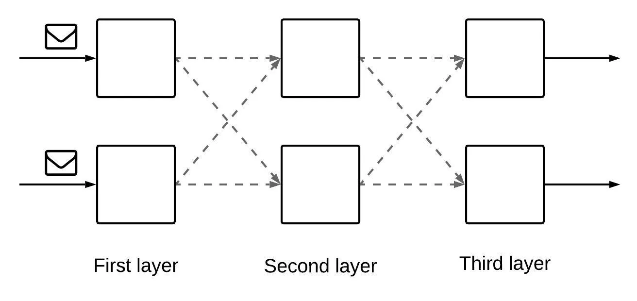

Therefore, the Nym mixnet deploys a stratified topology, which as research has shown, is optimal for anonymity and scalability [5]. In the stratified topology mix nodes are arranged into layers. Each node in layer i is connected with each node in the previous and next layer.
Stratified topology
The packets are source-routed, meaning that the sender selects the entire path to the destination. Each packet is sent via an independent path, composed by picking a single node from each layer at random. Although the packets are sent via independent routes, the stratified topology ensures that they interleave with each other at some point in the network, hence the entire traffic is eventually mixed together.
Most importantly, aggregating mixes into layers ensures a sparse topology that concentrates traffic on a few links and allows the Nym mixnet to scale horizontally, meaning that the overall capacity of the network can be increased by incrementally adding more servers.
Hence, the topology of Nym mixnet offers both strong anonymity and scalability.
