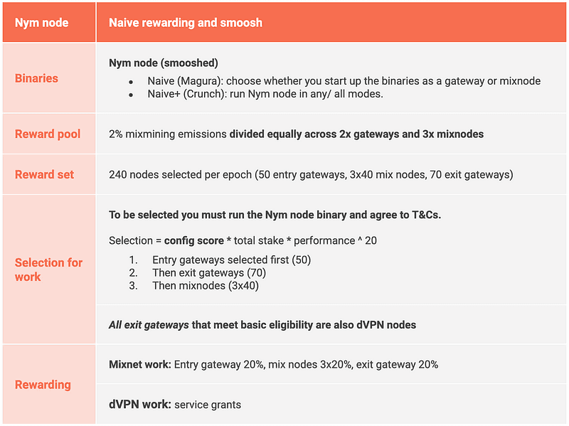

  1. The 2% emissions from the mixmining pool will now be distributed across 5 layers of active nodes rather than 3. This is to ensure that gateways are rewarded algorithmically rather than only via grants. The aim is to encourage more nodes to run in gateway mode and enable more gateway options for end-users.
  2. Action: Completion of project smoosh requires that operators upgrade to run the Nym node binary. This means operators will be running a single binary for either gateway or mix node mode. Gateways will have to get stake for the first time in order to be selected to the active set.
  3. A configuration score is now included in the node selection algorithm to determine if a node is included in the active set: Selection = config score * total stake * performance ^ 20. This is to cull any outdated nodes from the set and make sure the network is running up to date software.

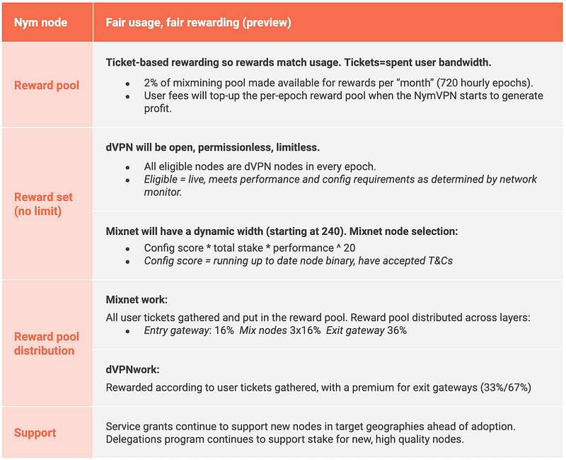

The end goal of Nym token economics is to have a virtuous cycle flywheel in which increasing adoption leads to a scaling of the network and rewards. Currently, stakers and node operators are rewarded from the mixmining pool, which is bootstrapping rewards while the network is free to use. With the network entering a paid version, rewards can soon become tied to real world usage.
Fair usage and fair rewards simply means that users will be paying for network services and that payments will enter the node reward pool with a percentage going towards topping up operator and staker rewards. But there is a lot more happening under the hood to make sure that:
  1. nodes are rewarded based on actual usage of their services
  2. measurement of actual usage does not deanonymize a user!
The Nym R&D and dev teams have been very busy this past year to flesh out this scheme, combining zero-knowledge cryptography, evolving the coconut credential scheme into “e-cash” and now finally the zk-nym credential scheme. Zk-nyms ensure that a user’s payment is entirely de-linked from their network usage. For a full breakdown of the virtuous cycle enabled by zk-nyms, read more here.
For stakers and operators, the end goal is to have a rapidly scalable network, with no limits on the number of gateways. Rewards will be based on tickets gathered by gateways and representing real usage. Nodes will be multi-functional. They will continuously have the chance to earn dVPN rewards as both entry and exit gateways. And they will compete with each other every epoch for the chance to earn additional rewards by getting into the active set of the Nym’s noise generating mixnet as either gateways or mixnodes.

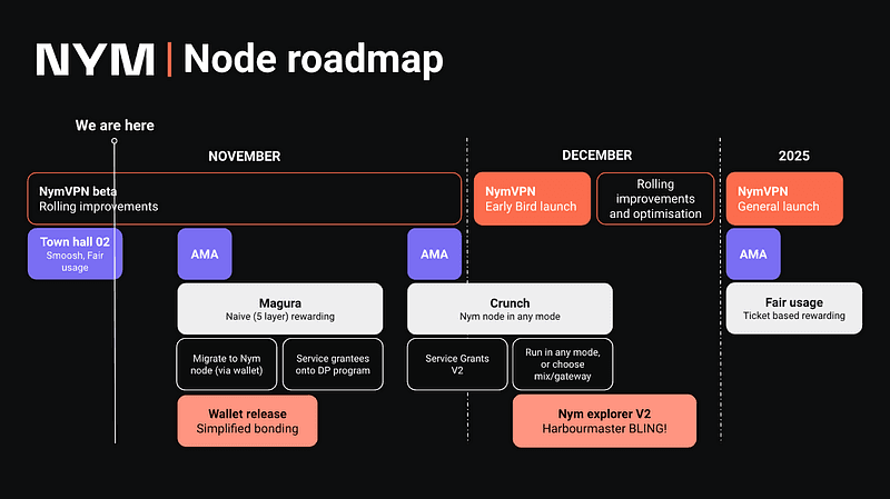

Here’s a breakdown of what to expect from the Nym node roadmap each month into 2025.
Mid-November
  • Release (Magura): The release will include gateways in the reward algorithm, with mixmining emissions divided across not just mixnodes, but also gateways. We expect this release to result in a slight decrease in mix node rewards due to more layers being rewarded, but with more chances for active set selection as old nodes will be removed.
  • Staker action: Review delegations and restake if necessary.
  • Operator action: Operators will at this point have to run up-to-date software, aka “smooshed” Nym nodes. They will also have to agree to operator T&Cs in order to be selected for the active set. Configuration scores will become part of the selection algorithm: config score * total stake * performance ^20
  • Team action: Onboard service grantees to the Delegations Program.
End of November
  • Release (Crunch): The release will include an IPv6 listener for gateways and allow operators to run a node in all modes (entry, exit gateway, and mix node, with all exit gateway-enabled nodes also serving as dVPN nodes).
  • Operator action: Enable your Nym node to run in all modes.
  • Team action: A new service grants program will the expand number and coverage of gateways.
December
  • NymVPN early bird launch
  • New network explorer release
  • Staker action: Use the explorer to explore nodes and fine-tune your staking for maximum network performance and staker rewards.
2025
  • Release: Fair network usage, fair rewarding. This is the fully-fledged paid version of the network. Rewards will be based on tickets gathered from usage, with rewards matching real world network usage. The mixmining pool will continue to bootstrap rewards as usage grows.
