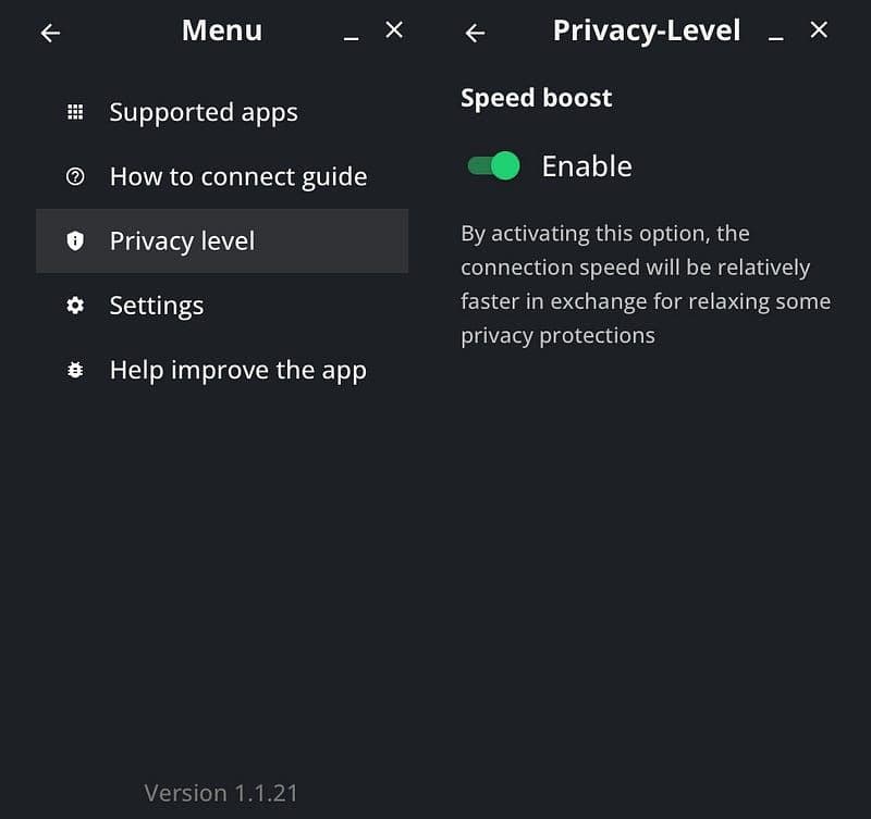

How to turn on Speedy Mode in NymConnect
Switching Speedy Mode on couldn’t be simpler.
Open NymConnect, click the menu icon, and navigate to ‘Privacy Level’.
Hit ‘Enable’ and that’s it — NymConnect is in Speedy Mode!
