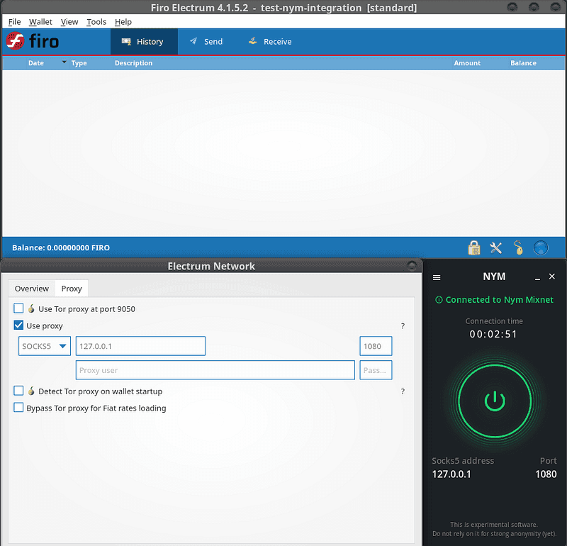

3. Download Firo Electrum wallet from Firo’s repository or the Github release page. To connect to the mixnet, follow these steps:
4. Start and connect NymConnect (or nym-socks5-client).
5. Start your Firo Electrum wallet, then navigate to: Tools -> Network -> Proxy
6. Set Use proxy to ✅, and choose SOCKS5 from the drop-down menu.
7. Go to NymConnect to copy your IP and Port values.
8. Go back to Firo and add the values from your NymConnect application.
Your Firo Electrum wallet now runs through the mixnet! This also means it will be connected and online only when your NymConnect or nym-socks5-client are connected. So remember to switch on NymConnect when you need to use your wallet!
