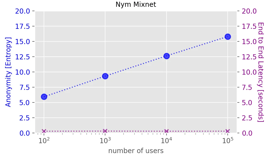

Following the Loopix design, Nym arranges mix nodes into a Stratified topology, in which nodes are grouped into layers and each node in layer i is connected with each node in the previous and next layer. Such topology scales horizontally, thus the Nym mixnet scales easily by adding more nodes to support a large user base without a negative impact on the end-to-end latency. Critically, the privacy provided by Nym increases as the network grows, i.e., the more traffic flows into the network, the larger the anonymity:

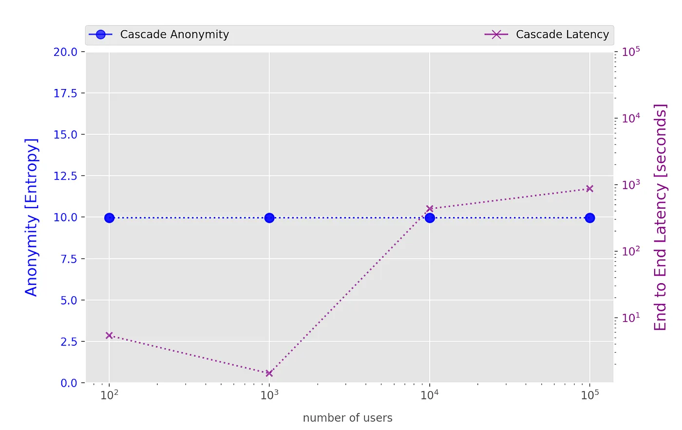

Traditional Chaumian mixnets use single cascade topology and the batch-and-reorder mixing technique, thus they scale very poorly and impose large latency overhead when the volume of traffic grows. As our analysis shows, traditional Chaumian mixnets impose high latency overhead not only when the volume of traffic is high, but also when it is low since each node waits a long time to collect a full batch for processing. Thus, the users have no control or prediction on the end-to-end latency of their packets.
An alternative approach to single cascades is to use multiple parallel cascades (Chaum’s latest cmix design). Such an approach allows the network to scale, however, the anonymity is still always constant and limited to the fixed size of the batch. Thus, an increasing number of users does not increase the anonymity of the network. In contrast to multi cascades mixnets, Nym provides much better anonymity for large volumes of users, while providing orders of magnitude lower E2E latency.¹

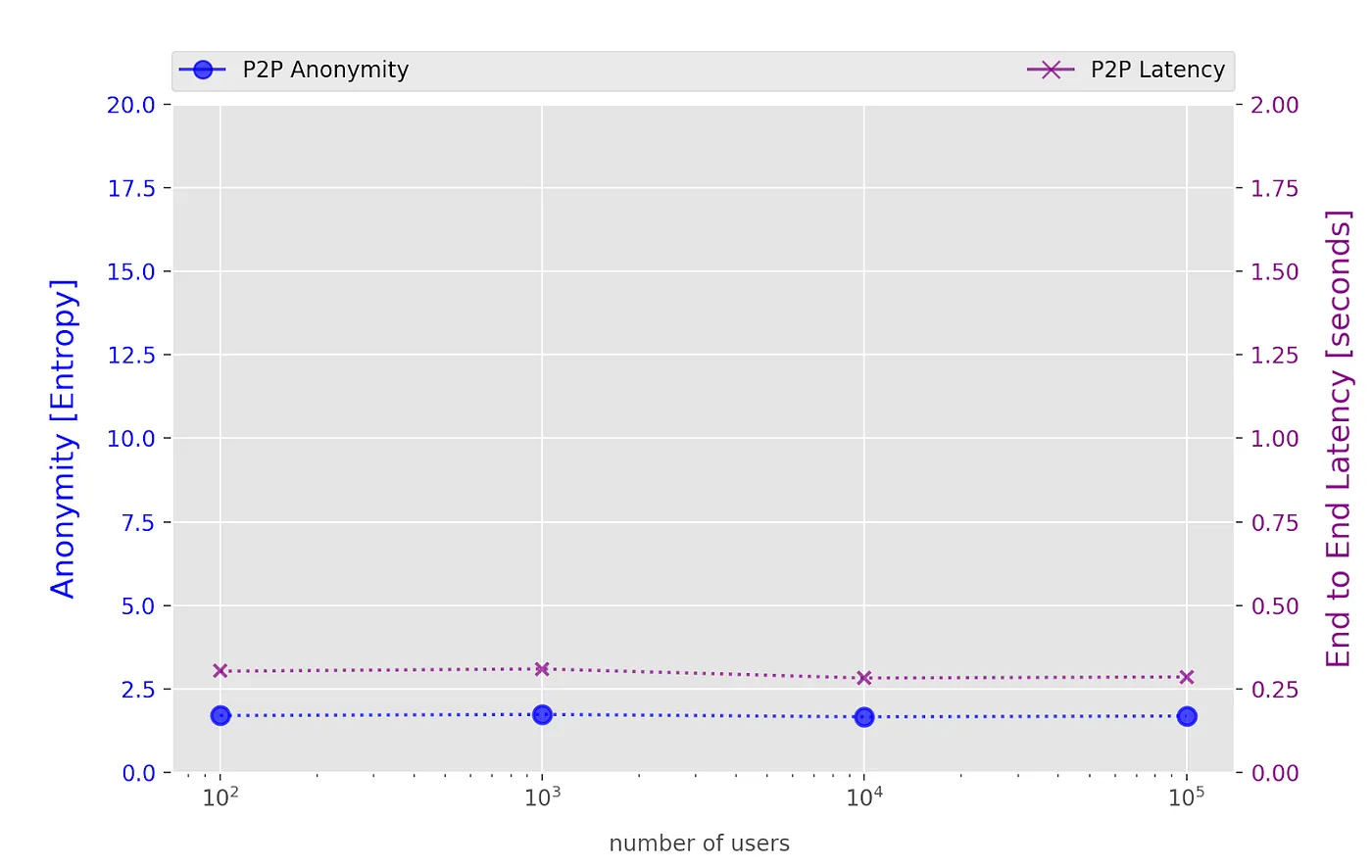

In contrast, P2P networks, like HOPR, although scale easily, provide very poor anonymity despite an increasing number of users. As the empirical study shows, for the same number of users and end-to-end latency Nym provides much larger anonymity than networks with P2P topology.¹,²

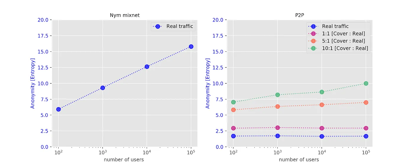

One way to improve the level of anonymity is to deploy cover traffic. However, as our analysis shows the P2P networks like e.g., HOPR needs huge volumes of cover traffic to reach the level of anonymity offered by Nym:
For example, as the above plots show in a P2P network with 100K users, each user must produce 10 cover packets for each 1 real packet they send to achieve similar anonymity as the Nym mixnet achieves for 1.6K users without any cover traffic, for the same end to end latency! While the network scales, a P2P approach will need more and more cover traffic to provide any reasonable anonymity, requiring the peers to be deployed on powerful machines.

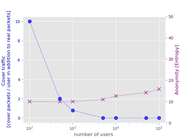

To illustrate that, we analyze how much cover traffic is needed in the Nym mixnet given changing numbers of users, assuming that our minimum desired entropy is approx 10.
As depicted, while for a small number of users we require high volumes of cover traffic, this amount quickly declines as the number of users increases. In our experiment for 5000 users, we already didn’t need any cover traffic to provide the desired anonymity (although we of course might want to use some cover traffic to boost the anonymity even more or hide our communication patterns). Imagine if the number of users grows to 1 million or 10 million! Therefore, the more users that join the Nym network, anonymity increases, and cover traffic becomes less necessary. This means the network scales privacy efficiently, unlike a simple-minded P2P design!

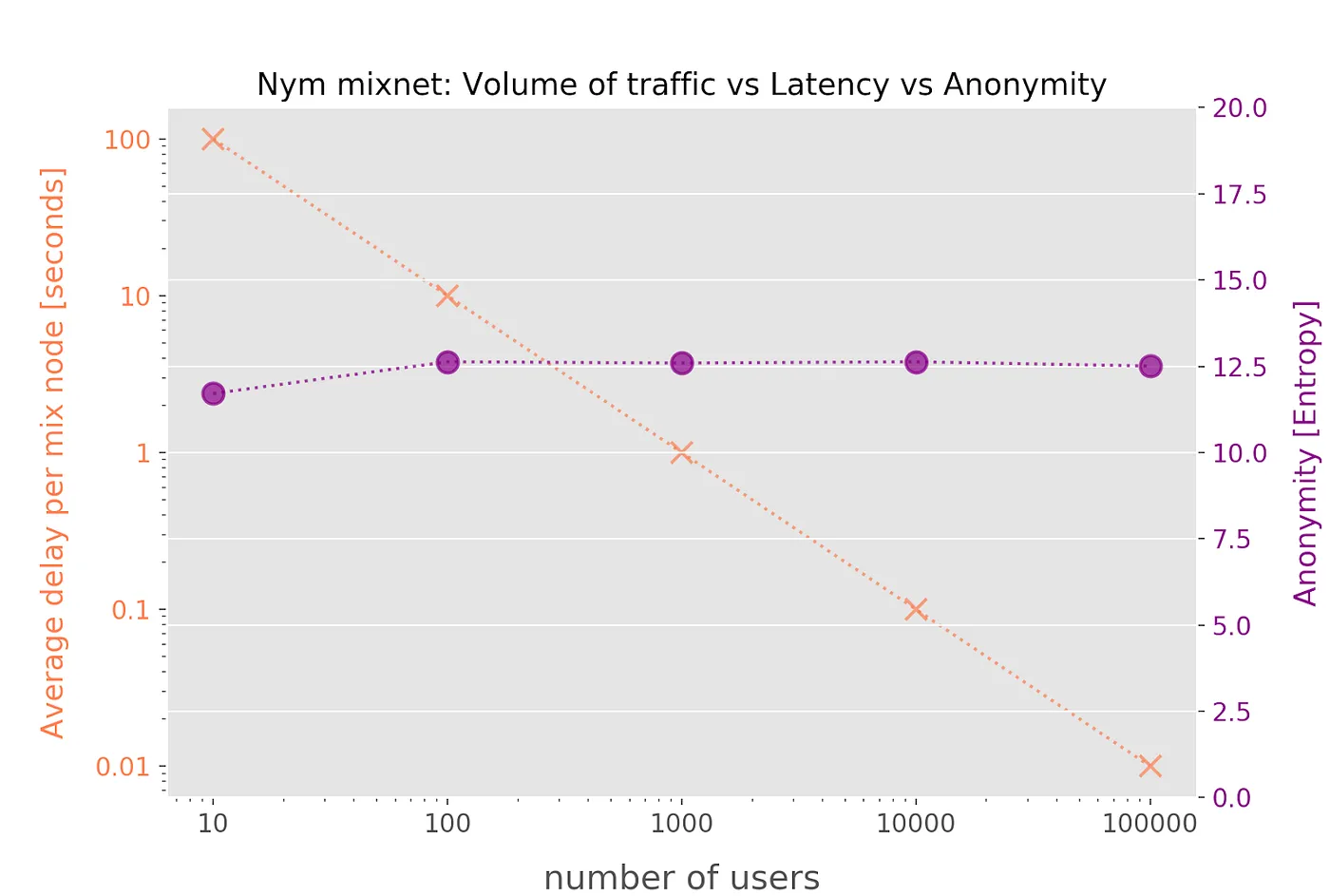

As we have shown earlier, thanks to the horizontal scalability Nym can support millions of users. As more users show up, you can scale up Nym by adding new mix nodes — just like you can scale up websites by adding new servers. This is crucial, as the increasing number of Nym users allows to tune down the mean parameter of the exponential distribution, and thus decrease the end-to-end latency, without sacrificing anonymity. As a result, the Nym mixnet becomes ‘faster’ as less per node mixing delay is required. In a nutshell, the more users join the network, not only is everyone more anonymous, but everyone benefits from higher speed!
