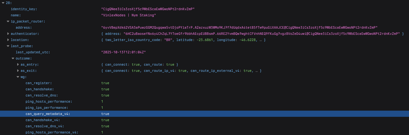

Nodes description can be queried from API endpoint /api/v1/description or via Swagger API UI page /api/v1/swagger/#/Node/description.
curl -X 'GET' \ 'http://<PUBLIC_IP>:8080/api/v1/description' \ -H 'accept: application/json' # or for https reversed proxy or WSS setup curl -X 'GET' \ 'https://<HOSTNAME>/api/v1/description' \ -H 'accept: application/json'

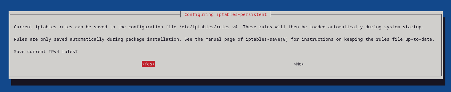

Install exit policy
  • Clear old rules and configure new ones:
./network-tunnel-manager.sh exit_policy_clear ./network-tunnel-manager.sh exit_policy_install
  • The output should look like this:
iptables-persistent is already installed. Configuring IP forwarding... net.ipv6.conf.all.forwarding=1 net.ipv4.ip_forward=1 net.ipv6.conf.all.forwarding = 1 net.ipv4.ip_forward = 1 IP forwarding configured successfully. Creating Nym exit policy chain... Chain NYM-EXIT already exists. Flushing it... Chain NYM-EXIT already exists in ip6tables. Flushing it... NYM-EXIT all opt -- in * out nymwg 0.0.0.0/0 -> 0.0.0.0/0 NYM-EXIT all opt in * out nymwg ::/0 -> ::/0 Setting up NAT rules... MASQUERADE all opt -- in * out ens3 0.0.0.0/0 -> 0.0.0.0/0 IPv4 NAT rule already exists. MASQUERADE all opt in * out ens3 ::/0 -> ::/0 IPv6 NAT rule already exists. ACCEPT all opt -- in nymwg out ens3 0.0.0.0/0 -> 0.0.0.0/0 ACCEPT all opt -- in ens3 out nymwg 0.0.0.0/0 -> 0.0.0.0/0 state RELATED,ESTABLISHED ACCEPT all opt in nymwg out ens3 ::/0 -> ::/0 ACCEPT all opt in ens3 out nymwg ::/0 -> ::/0 state RELATED,ESTABLISHED Configuring DNS and ICMP rules... ACCEPT icmp opt -- in * out * 0.0.0.0/0 -> 0.0.0.0/0 icmptype 8 ACCEPT icmp opt -- in * out * 0.0.0.0/0 -> 0.0.0.0/0 icmptype 0 ACCEPT icmpv6 opt in * out * ::/0 -> ::/0 ACCEPT udp opt -- in * out * 0.0.0.0/0 -> 0.0.0.0/0 udp dpt:53 ACCEPT tcp opt -- in * out * 0.0.0.0/0 -> 0.0.0.0/0 tcp dpt:53 ACCEPT udp opt in * out * ::/0 -> ::/0 udp dpt:53 ACCEPT tcp opt in * out * ::/0 -> ::/0 tcp dpt:53 Applying Spamhaus blocklist... Downloading exit policy from https://nymtech.net/.wellknown/network-requester/exit-policy.txt Processing 429 blocklist rules... REJECT all opt -- in * out * 0.0.0.0/0 -> 205.189.71.0/24 reject-with icmp-port-unreachable REJECT all opt -- in * out * 0.0.0.0/0 -> 205.189.72.0/23 reject-with icmp-port-unreachable Blocklist applied successfully. Applying allowed ports... Adding rules for SILC (Port: 706) Added: NYM-EXIT tcp port 706 Added: NYM-EXIT tcp port 706 Added: NYM-EXIT udp port 706 Added: NYM-EXIT udp port 706 Adding rules for PostgreSQL (Port: 5432) Added: NYM-EXIT tcp port 5432 Added: NYM-EXIT tcp port 5432 Added: NYM-EXIT udp port 5432 Added: NYM-EXIT udp port 5432 Adding rules for CPanel (Port: 2082-2083) Added: NYM-EXIT tcp port range 2082:2083 Added: NYM-EXIT tcp port range 2082:2083 Added: NYM-EXIT udp port range 2082:2083 Added: NYM-EXIT udp port range 2082:2083 Adding rules for Zcash (Port: 8232-8233) Added: NYM-EXIT tcp port range 8232:8233 Added: NYM-EXIT tcp port range 8232:8233 Added: NYM-EXIT udp port range 8232:8233 Added: NYM-EXIT udp port range 8232:8233 Adding rules for VLSILicenseManager (Port: 1500) Added: NYM-EXIT tcp port 1500 Added: NYM-EXIT tcp port 1500 Added: NYM-EXIT udp port 1500 Added: NYM-EXIT udp port 1500 Adding rules for NTP (Port: 123) Added: NYM-EXIT tcp port 123 Added: NYM-EXIT tcp port 123 Added: NYM-EXIT udp port 123 Added: NYM-EXIT udp port 123 Adding rules for PKTKRB (Port: 1293) Added: NYM-EXIT tcp port 1293 Added: NYM-EXIT tcp port 1293 Added: NYM-EXIT udp port 1293 Added: NYM-EXIT udp port 1293 Adding rules for OpenPGP (Port: 11371) Added: NYM-EXIT tcp port 11371 Added: NYM-EXIT tcp port 11371 Added: NYM-EXIT udp port 11371 Added: NYM-EXIT udp port 11371 Adding rules for HTTPS (Port: 443) Added: NYM-EXIT tcp port 443 Added: NYM-EXIT tcp port 443 Added: NYM-EXIT udp port 443 Added: NYM-EXIT udp port 443 Adding rules for POP3 (Port: 110) Added: NYM-EXIT tcp port 110 Added: NYM-EXIT tcp port 110 Added: NYM-EXIT udp port 110 Added: NYM-EXIT udp port 110 Adding rules for OpenVPN (Port: 1194) Added: NYM-EXIT tcp port 1194 Added: NYM-EXIT tcp port 1194 Added: NYM-EXIT udp port 1194 Added: NYM-EXIT udp port 1194 Adding rules for XboxLive (Port: 3074) Added: NYM-EXIT tcp port 3074 Added: NYM-EXIT tcp port 3074 Added: NYM-EXIT udp port 3074 Added: NYM-EXIT udp port 3074 Adding rules for OracleDB (Port: 1521) Added: NYM-EXIT tcp port 1521 Added: NYM-EXIT tcp port 1521 Added: NYM-EXIT udp port 1521 Added: NYM-EXIT udp port 1521 Adding rules for NFS (Port: 2049) Added: NYM-EXIT tcp port 2049 Added: NYM-EXIT tcp port 2049 Added: NYM-EXIT udp port 2049 Added: NYM-EXIT udp port 2049 Adding rules for Kerberos (Port: 88) Added: NYM-EXIT tcp port 88 Added: NYM-EXIT tcp port 88 Added: NYM-EXIT udp port 88 Added: NYM-EXIT udp port 88 Adding rules for POP3OverTLS (Port: 995) Added: NYM-EXIT tcp port 995 Added: NYM-EXIT tcp port 995 Added: NYM-EXIT udp port 995 Added: NYM-EXIT udp port 995 Adding rules for DarkFiTor (Port: 25551) Added: NYM-EXIT tcp port 25551 Added: NYM-EXIT tcp port 25551 Added: NYM-EXIT udp port 25551 Added: NYM-EXIT udp port 25551 Adding rules for MMCC (Port: 5050) Added: NYM-EXIT tcp port 5050 Added: NYM-EXIT tcp port 5050 Added: NYM-EXIT udp port 5050 Added: NYM-EXIT udp port 5050 Adding rules for WHOIS (Port: 43) Added: NYM-EXIT tcp port 43 Added: NYM-EXIT tcp port 43 Added: NYM-EXIT udp port 43 Added: NYM-EXIT udp port 43 Adding rules for NetnewsAdmin (Port: 991) Added: NYM-EXIT tcp port 991 Added: NYM-EXIT tcp port 991 Added: NYM-EXIT udp port 991 Added: NYM-EXIT udp port 991 Adding rules for IMAP (Port: 143) Added: NYM-EXIT tcp port 143 Added: NYM-EXIT tcp port 143 Added: NYM-EXIT udp port 143 Added: NYM-EXIT udp port 143 Adding rules for AndroidMarket (Port: 5228) Added: NYM-EXIT tcp port 5228 Added: NYM-EXIT tcp port 5228 Added: NYM-EXIT udp port 5228 Added: NYM-EXIT udp port 5228 Adding rules for SMBWindowsFileShare (Port: 445) Added: NYM-EXIT tcp port 445 Added: NYM-EXIT tcp port 445 Added: NYM-EXIT udp port 445 Added: NYM-EXIT udp port 445 Adding rules for RTSPAlt (Port: 1755) Added: NYM-EXIT tcp port 1755 Added: NYM-EXIT tcp port 1755 Added: NYM-EXIT udp port 1755 Added: NYM-EXIT udp port 1755 Adding rules for IMAPOverTLS (Port: 993) Added: NYM-EXIT tcp port 993 Added: NYM-EXIT tcp port 993 Added: NYM-EXIT udp port 993 Added: NYM-EXIT udp port 993 Adding rules for TorORPort (Port: 9001) Added: NYM-EXIT tcp port 9001 Added: NYM-EXIT tcp port 9001 Added: NYM-EXIT udp port 9001 Added: NYM-EXIT udp port 9001 Adding rules for XMPP (Port: 5222-5223) Added: NYM-EXIT tcp port range 5222:5223 Added: NYM-EXIT tcp port range 5222:5223 Added: NYM-EXIT udp port range 5222:5223 Added: NYM-EXIT udp port range 5222:5223 Adding rules for FTP (Port: 20-21) Added: NYM-EXIT tcp port range 20:21 Added: NYM-EXIT tcp port range 20:21 Added: NYM-EXIT udp port range 20:21 Added: NYM-EXIT udp port range 20:21 Adding rules for MOSH (Port: 60000-61000) Added: NYM-EXIT tcp port range 60000:61000 Added: NYM-EXIT tcp port range 60000:61000 Added: NYM-EXIT udp port range 60000:61000 Added: NYM-EXIT udp port range 60000:61000 Adding rules for Zephyr (Port: 2102-2104) Added: NYM-EXIT tcp port range 2102:2104 Added: NYM-EXIT tcp port range 2102:2104 Added: NYM-EXIT udp port range 2102:2104 Added: NYM-EXIT udp port range 2102:2104 Adding rules for Rsync (Port: 873) Added: NYM-EXIT tcp port 873 Added: NYM-EXIT tcp port 873 Added: NYM-EXIT udp port 873 Added: NYM-EXIT udp port 873 Adding rules for Steam (Port: 27000-27050) Added: NYM-EXIT tcp port range 27000:27050 Added: NYM-EXIT tcp port range 27000:27050 Added: NYM-EXIT udp port range 27000:27050 Added: NYM-EXIT udp port range 27000:27050 Adding rules for Git (Port: 9418) Added: NYM-EXIT tcp port 9418 Added: NYM-EXIT tcp port 9418 Added: NYM-EXIT udp port 9418 Added: NYM-EXIT udp port 9418 Adding rules for MSNP (Port: 1863) Added: NYM-EXIT tcp port 1863 Added: NYM-EXIT tcp port 1863 Added: NYM-EXIT udp port 1863 Added: NYM-EXIT udp port 1863 Adding rules for SimplifyMedia (Port: 8087-8088) Added: NYM-EXIT tcp port range 8087:8088 Added: NYM-EXIT tcp port range 8087:8088 Added: NYM-EXIT udp port range 8087:8088 Added: NYM-EXIT udp port range 8087:8088 Adding rules for TorDirPort (Port: 9030) Added: NYM-EXIT tcp port 9030 Added: NYM-EXIT tcp port 9030 Added: NYM-EXIT udp port 9030 Added: NYM-EXIT udp port 9030 Adding rules for Virtuozzo (Port: 4643) Added: NYM-EXIT tcp port 4643 Added: NYM-EXIT tcp port 4643 Added: NYM-EXIT udp port 4643 Added: NYM-EXIT udp port 4643 Adding rules for Gaming (Port: 9339) Added: NYM-EXIT tcp port 9339 Added: NYM-EXIT tcp port 9339 Added: NYM-EXIT udp port 9339 Added: NYM-EXIT udp port 9339 Adding rules for VMware (Port: 902-904) Added: NYM-EXIT tcp port range 902:904 Added: NYM-EXIT tcp port range 902:904 Added: NYM-EXIT udp port range 902:904 Added: NYM-EXIT udp port range 902:904 Adding rules for Sametime (Port: 1533) Added: NYM-EXIT tcp port 1533 Added: NYM-EXIT tcp port 1533 Added: NYM-EXIT udp port 1533 Added: NYM-EXIT udp port 1533 Adding rules for NBX (Port: 2095-2096) Added: NYM-EXIT tcp port range 2095:2096 Added: NYM-EXIT tcp port range 2095:2096 Added: NYM-EXIT udp port range 2095:2096 Added: NYM-EXIT udp port range 2095:2096 Adding rules for ICQ (Port: 5190) Added: NYM-EXIT tcp port 5190 Added: NYM-EXIT tcp port 5190 Added: NYM-EXIT udp port 5190 Added: NYM-EXIT udp port 5190 Adding rules for KerberosAdmin (Port: 749) Added: NYM-EXIT tcp port 749 Added: NYM-EXIT tcp port 749 Added: NYM-EXIT udp port 749 Added: NYM-EXIT udp port 749 Adding rules for RWHOIS (Port: 4321) Added: NYM-EXIT tcp port 4321 Added: NYM-EXIT tcp port 4321 Added: NYM-EXIT udp port 4321 Added: NYM-EXIT udp port 4321 Adding rules for NDMP (Port: 10000) Added: NYM-EXIT tcp port 10000 Added: NYM-EXIT tcp port 10000 Added: NYM-EXIT udp port 10000 Added: NYM-EXIT udp port 10000 Adding rules for DNS (Port: 53) Added: NYM-EXIT tcp port 53 Added: NYM-EXIT tcp port 53 Added: NYM-EXIT udp port 53 Added: NYM-EXIT udp port 53 Adding rules for GoogleVoice (Port: 19294) Added: NYM-EXIT tcp port 19294 Added: NYM-EXIT tcp port 19294 Added: NYM-EXIT udp port 19294 Added: NYM-EXIT udp port 19294 Adding rules for IMAP3 (Port: 220) Added: NYM-EXIT tcp port 220 Added: NYM-EXIT tcp port 220 Added: NYM-EXIT udp port 220 Added: NYM-EXIT udp port 220 Adding rules for Bitcoin (Port: 8332-8333) Added: NYM-EXIT tcp port range 8332:8333 Added: NYM-EXIT tcp port range 8332:8333 Added: NYM-EXIT udp port range 8332:8333 Added: NYM-EXIT udp port range 8332:8333 Adding rules for Mumble (Port: 64738) Added: NYM-EXIT tcp port 64738 Added: NYM-EXIT tcp port 64738 Added: NYM-EXIT udp port 64738 Added: NYM-EXIT udp port 64738 Adding rules for DarkFi (Port: 26661) Added: NYM-EXIT tcp port 26661 Added: NYM-EXIT tcp port 26661 Added: NYM-EXIT udp port 26661 Added: NYM-EXIT udp port 26661 Adding rules for PPTP (Port: 1723) Added: NYM-EXIT tcp port 1723 Added: NYM-EXIT tcp port 1723 Added: NYM-EXIT udp port 1723 Added: NYM-EXIT udp port 1723 Adding rules for HTTPSALT (Port: 8443) Added: NYM-EXIT tcp port 8443 Added: NYM-EXIT tcp port 8443 Added: NYM-EXIT udp port 8443 Added: NYM-EXIT udp port 8443 Adding rules for HTTPProxy (Port: 8888) Added: NYM-EXIT tcp port 8888 Added: NYM-EXIT tcp port 8888 Added: NYM-EXIT udp port 8888 Added: NYM-EXIT udp port 8888 Adding rules for GNUnet (Port: 2086-2087) Added: NYM-EXIT tcp port range 2086:2087 Added: NYM-EXIT tcp port range 2086:2087 Added: NYM-EXIT udp port range 2086:2087 Added: NYM-EXIT udp port range 2086:2087 Adding rules for Lightning (Port: 9735) Added: NYM-EXIT tcp port 9735 Added: NYM-EXIT tcp port 9735 Added: NYM-EXIT udp port 9735 Added: NYM-EXIT udp port 9735 Adding rules for RTSP (Port: 554) Added: NYM-EXIT tcp port 554 Added: NYM-EXIT tcp port 554 Added: NYM-EXIT udp port 554 Added: NYM-EXIT udp port 554 Adding rules for DNSOverTLS (Port: 853) Added: NYM-EXIT tcp port 853 Added: NYM-EXIT tcp port 853 Added: NYM-EXIT udp port 853 Added: NYM-EXIT udp port 853 Adding rules for SSH (Port: 22) Added: NYM-EXIT tcp port 22 Added: NYM-EXIT tcp port 22 Added: NYM-EXIT udp port 22 Added: NYM-EXIT udp port 22 Adding rules for Electrum (Port: 8082) Added: NYM-EXIT tcp port 8082 Added: NYM-EXIT tcp port 8082 Added: NYM-EXIT udp port 8082 Added: NYM-EXIT udp port 8082 Adding rules for TelnetOverTLS (Port: 992) Added: NYM-EXIT tcp port 992 Added: NYM-EXIT tcp port 992 Added: NYM-EXIT udp port 992 Added: NYM-EXIT udp port 992 Adding rules for Minecraft (Port: 25565) Added: NYM-EXIT tcp port 25565 Added: NYM-EXIT tcp port 25565 Added: NYM-EXIT udp port 25565 Added: NYM-EXIT udp port 25565 Adding rules for SVN (Port: 3690) Added: NYM-EXIT tcp port 3690 Added: NYM-EXIT tcp port 3690 Added: NYM-EXIT udp port 3690 Added: NYM-EXIT udp port 3690 Adding rules for Kpasswd (Port: 464) Added: NYM-EXIT tcp port 464 Added: NYM-EXIT tcp port 464 Added: NYM-EXIT udp port 464 Added: NYM-EXIT udp port 464 Adding rules for MoneroRPC (Port: 18089) Added: NYM-EXIT tcp port 18089 Added: NYM-EXIT tcp port 18089 Added: NYM-EXIT udp port 18089 Added: NYM-EXIT udp port 18089 Adding rules for RemoteHTTPS (Port: 981) Added: NYM-EXIT tcp port 981 Added: NYM-EXIT tcp port 981 Added: NYM-EXIT udp port 981 Added: NYM-EXIT udp port 981 Adding rules for Tari (Port: 9053) Added: NYM-EXIT tcp port 9053 Added: NYM-EXIT tcp port 9053 Added: NYM-EXIT udp port 9053 Added: NYM-EXIT udp port 9053 Adding rules for ElectrumSSL (Port: 50002) Added: NYM-EXIT tcp port 50002 Added: NYM-EXIT tcp port 50002 Added: NYM-EXIT udp port 50002 Added: NYM-EXIT udp port 50002 Adding rules for HTTPSALT2 (Port: 9443) Added: NYM-EXIT tcp port 9443 Added: NYM-EXIT tcp port 9443 Added: NYM-EXIT udp port 9443 Added: NYM-EXIT udp port 9443 Adding rules for LDAP (Port: 389) Added: NYM-EXIT tcp port 389 Added: NYM-EXIT tcp port 389 Added: NYM-EXIT udp port 389 Added: NYM-EXIT udp port 389 Adding rules for HTTP (Port: 80-81) Added: NYM-EXIT tcp port range 80:81 Added: NYM-EXIT tcp port range 80:81 Added: NYM-EXIT udp port range 80:81 Added: NYM-EXIT udp port range 80:81 Adding rules for MongoDBDefault (Port: 27017) Added: NYM-EXIT tcp port 27017 Added: NYM-EXIT tcp port 27017 Added: NYM-EXIT udp port 27017 Added: NYM-EXIT udp port 27017 Adding rules for RTPVOIP (Port: 5000-5005) Added: NYM-EXIT tcp port range 5000:5005 Added: NYM-EXIT tcp port range 5000:5005 Added: NYM-EXIT udp port range 5000:5005 Added: NYM-EXIT udp port range 5000:5005 Adding rules for MSSQL (Port: 1433) Added: NYM-EXIT tcp port 1433 Added: NYM-EXIT tcp port 1433 Added: NYM-EXIT udp port 1433 Added: NYM-EXIT udp port 1433 Adding rules for MQTTS (Port: 8883) Added: NYM-EXIT tcp port 8883 Added: NYM-EXIT tcp port 8883 Added: NYM-EXIT udp port 8883 Added: NYM-EXIT udp port 8883 Adding rules for MySQL (Port: 3306) Added: NYM-EXIT tcp port 3306 Added: NYM-EXIT tcp port 3306 Added: NYM-EXIT udp port 3306 Added: NYM-EXIT udp port 3306 Adding rules for TeamSpeak (Port: 8767) Added: NYM-EXIT tcp port 8767 Added: NYM-EXIT tcp port 8767 Added: NYM-EXIT udp port 8767 Added: NYM-EXIT udp port 8767 Adding rules for GroupWise (Port: 1677) Added: NYM-EXIT tcp port 1677 Added: NYM-EXIT tcp port 1677 Added: NYM-EXIT udp port 1677 Added: NYM-EXIT udp port 1677 Adding rules for Monero (Port: 18080-18081) Added: NYM-EXIT tcp port range 18080:18081 Added: NYM-EXIT tcp port range 18080:18081 Added: NYM-EXIT udp port range 18080:18081 Added: NYM-EXIT udp port range 18080:18081 Adding rules for EnsimControlPanel (Port: 19638) Added: NYM-EXIT tcp port 19638 Added: NYM-EXIT tcp port 19638 Added: NYM-EXIT udp port 19638 Added: NYM-EXIT udp port 19638 Adding rules for QTServerAdmin (Port: 1220) Added: NYM-EXIT tcp port 1220 Added: NYM-EXIT tcp port 1220 Added: NYM-EXIT udp port 1220 Added: NYM-EXIT udp port 1220 Adding rules for Finger (Port: 79) Added: NYM-EXIT tcp port 79 Added: NYM-EXIT tcp port 79 Added: NYM-EXIT udp port 79 Added: NYM-EXIT udp port 79 Adding rules for FTPOverTLS (Port: 989-990) Added: NYM-EXIT tcp port range 989:990 Added: NYM-EXIT tcp port range 989:990 Added: NYM-EXIT udp port range 989:990 Added: NYM-EXIT udp port range 989:990 Adding rules for LDAPS (Port: 636) Added: NYM-EXIT tcp port 636 Added: NYM-EXIT tcp port 636 Added: NYM-EXIT udp port 636 Added: NYM-EXIT udp port 636 Adding default reject rule... Default reject rule added successfully. Port allowlist applied successfully. Saving iptables rules to make them persistent... Rules saved to /etc/iptables/rules.v4 and /etc/iptables/rules.v6 Nym exit policy installed successfully.

Validate the setup
Once the Node Status API has run a probe on your node, can_query_metadata_v4 will be true. Find your node in the NymVPN gateways directory  — the same entry publishes your bridge under bridges. With nym-bridge v0.3.0 you should see all three transports (quic_plain, tls_plain, ssh_plain) in transports_v2:
{ "bridges": { "version": "0", "transports": [ { "transport_type": "quic_plain", "args": { "addresses": [ "194.182.160.190:4443", "[2a04:c43:e00:6f28:491:eaff:fe00:f53]:4443" ], "host": "netdna.bootstrapcdn.com", "id_pubkey": "C/lyTiCDyqavLWhVVquj/AyU1vPQxtp0cPS+v2jGg9Y=" } } ], "transports_v2": [ { "transport_type": "quic_plain", "args": { "addresses": [ "194.182.160.190:4443", "[2a04:c43:e00:6f28:491:eaff:fe00:f53]:4443" ], "host": "netdna.bootstrapcdn.com", "id_pubkey": "C/lyTiCDyqavLWhVVquj/AyU1vPQxtp0cPS+v2jGg9Y=" } }, { "transport_type": "tls_plain", "args": { "addresses": [ "194.182.160.190:4443", "[2a04:c43:e00:6f28:491:eaff:fe00:f53]:4443" ], "host": "netdna.bootstrapcdn.com", "id_pubkey": "r5qjW8ITHamuvP5iSunSMRPe2yUoIRUrI6vParHMaws=" } }, { "transport_type": "ssh_plain", "args": { "addresses": [ "194.182.160.190:4422", "[2a04:c43:e00:6f28:491:eaff:fe00:f53]:4422" ], "id_pubkey": "cXnoMTlcqwHqlLxEOCKtEwSFVb2siQrQF/a4AmN2wjU=", "username": null, "client_auth_key": "ALloM3IL7nkS18GXpdrjez+m6k+fUvAPQztv1gQyeMw=", "client_banner": null } } ] } }
