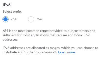

  3. Checkout your VPS dashboard and make sure your IPv6-public enabled.
  4. If you are able to add IPv6 address /64 range, do it.
VPS dashboard with the option to add a /64 IPv6 address range
