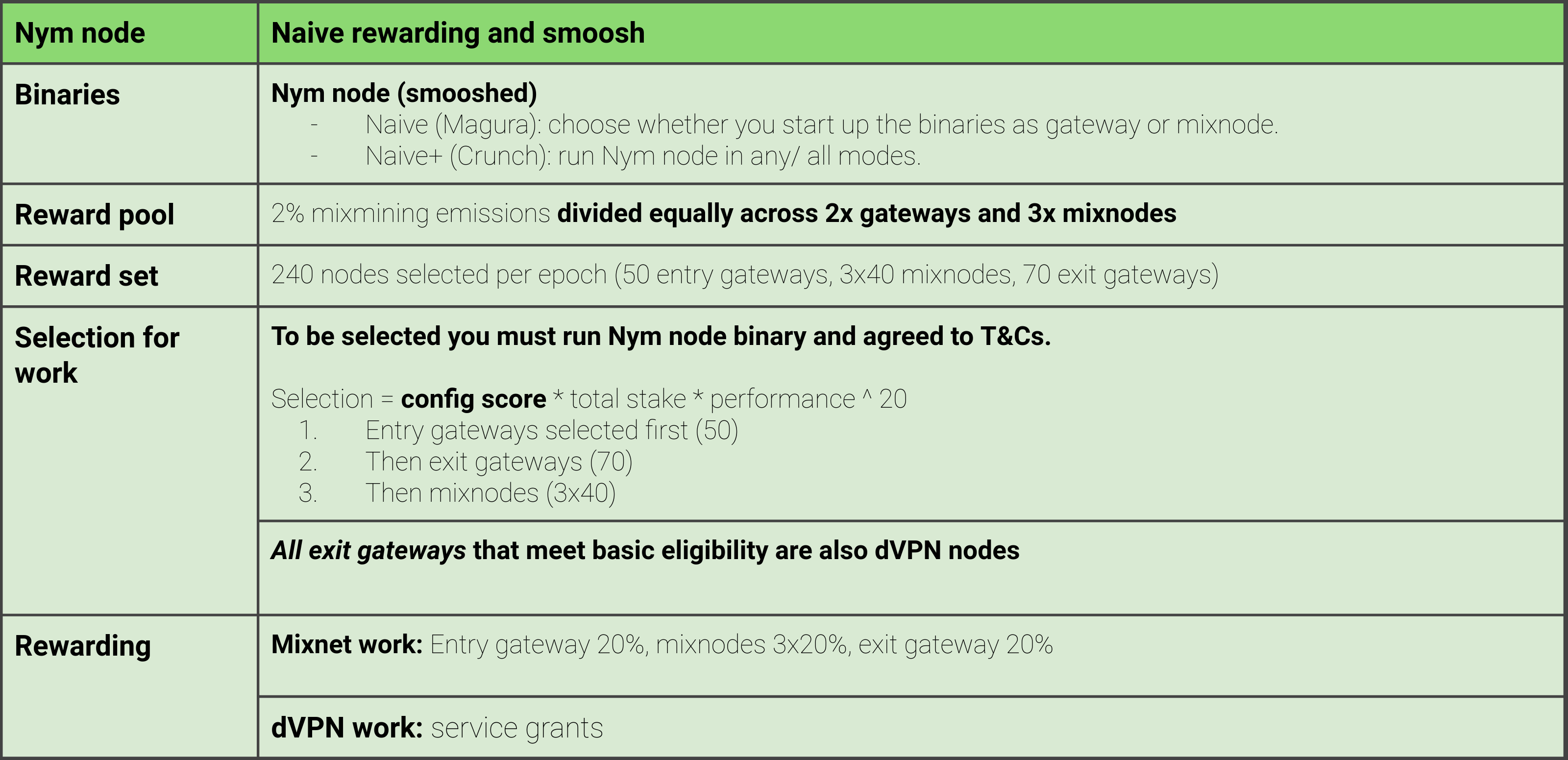

  • The current reward system is called Naive rewarding - an intermediate step - where the operators of nym-node get rewarded from Mixmining pool , which emits
    4_312
    NYM per hour
  • Only nodes selected to rewarded set of Mixnet receive rewards
  • The rewarded set of the Mixnet is currently 240 nodes in total and it’s selected for each new epoch (60 min), from all the nodes registered (bonded) in the network
  • Each node gets the same proportion of work factor because of the naive distribution of work

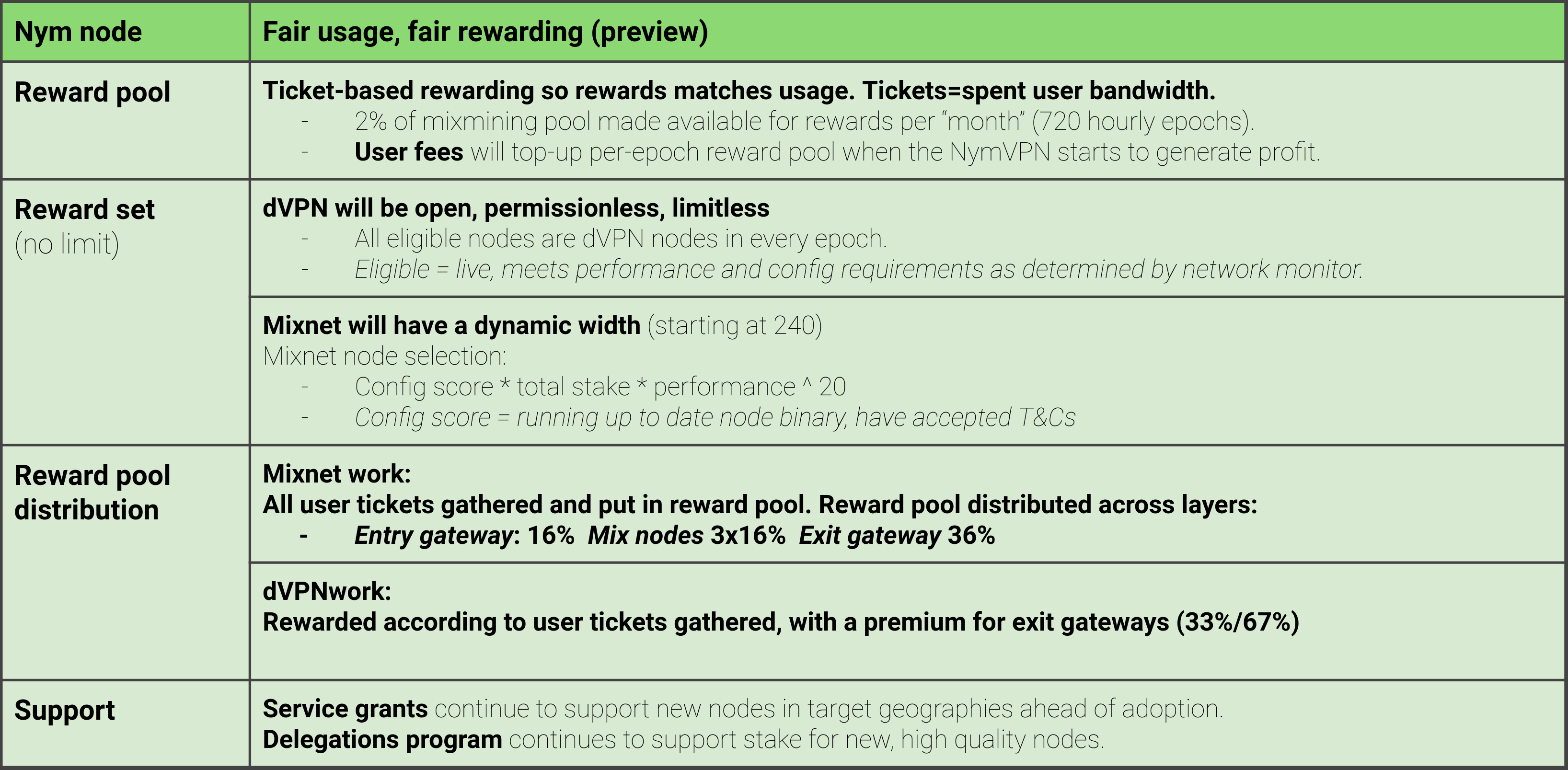

  • In the final model, nodes will get rewarded based on their layer position and the work they do (collected user tickets), where the work factor distribution per layer will be according to a decision made by the operators
  • If a node is selected to the rewarded set, it will be rewarded in the end of the epoch, based on this reward calculation formula:

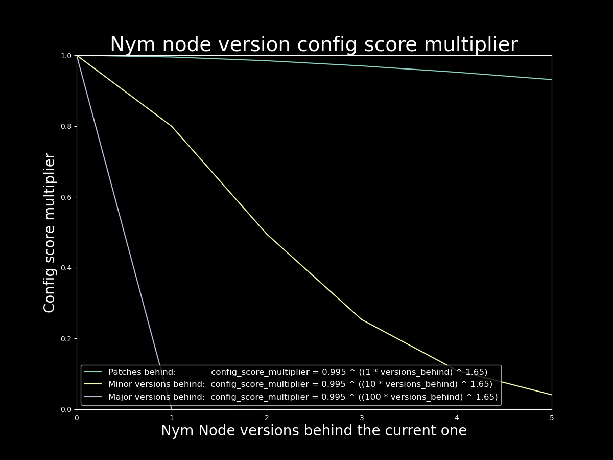

Versions Behind Calculation
ℹ️
The API version (“semver”) will be updated 96h (4 days) after the release is labeled as latest.
From release 2024.14-crunch (nym-node v1.2.0), the config_score parameter takes into account also nodes version (denoted as versions_behind). The “current version” is the one marked as Latest in the repository . The parameter versions_behind indicates the number of versions between the Latest version and the version run by the node, and it is factored into the config score with this formula:
0.995 ^ ( ( X * versions_behind ) ^ 1.65 )
where:
X = 1; for patches
X = 10; for minor versions
X = 100; for major versions
The exact parameters are live accessible on /v1/status/config-score-details.
Our versioning convention is: major_version . minor_version . patch
For example nym-node on version 1.2.0 is on 1st major version, 2nd minor and 0 patches.
Note that the X multiplier heavily lowers the config_score when nodes are outdated with respect to more significant updates. See the table and graph below:
Version behindPatches (X = 1)Minor versions (X = 10)Major versions (X = 100)
0 (current version)1.01.01.0
10.9950.79940.0000
20.98440.49530.0000
30.96980.25360.0000
40.95180.11020.0000
50.93110.04130.0000
Graph of the version score against the number of versions a node is behind
As you can see above, the algorithm is designed to give maximum selection score (1) to the latest version, while non-upgraded nodes receive a lower score. The score decreases faster when the node has failed to make a major version upgrade, and slower when the node is behind only with minor updates. This scoring de-prioritizes the selection of outdated nodes, even if their saturation and performance are high. Nodes are selected probabilistically in each epoch (60 min), according to their scores, to be part of the Rewarded set. This scoring mechanism gives priority to the operators running up-to-date nodes, ensuring that the network is as updated as possible.

Naive Rewarding
Naive rewarding is the current tokenomics design. The naive rewarding roadmap diagram lists features and logic of this design.
Roadmap diagram of the Naive rewarding model
Fair Mixnet
Fair Mixnet is the final architecture model that we work towards. The table below lists features and logic of the design once implemented.
Roadmap diagram of the Fair Mixnet model
